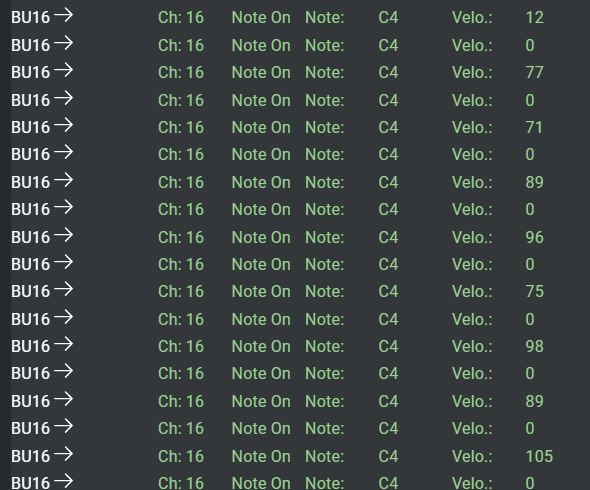

Velocities with the module by itself.

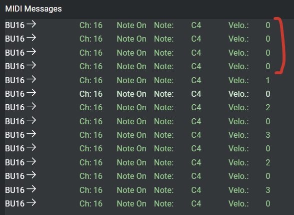

Velocities with the BU16 and EN16 together. The first “0” are triggered by high velocity pushes.
This behavior has been recorder with the units plugged to a PC via USB 3.0.
Same behavior is detected when using external gear like the 1010 Blackbox via the dedicated device USB.
Thanks in advance.
Cheers.
