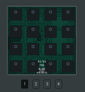

What is your FW version? Shown in Editor here as v1.5.1:

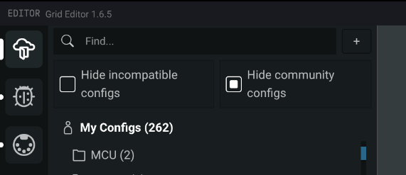

What is your Editor version? Shown in Editor here as 1.6.5:
I’m guessing your 1.5.7 version is your Editor version which is from last summer, yeah.
