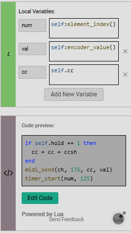

Could you please show me your Grid Editor settings?
Here, one of my encoders.
if self.hold == 1 then
  cc = cc + ccsh
end
midi_send(ch, 176, cc, val)
timer_start(num, 125)
