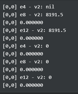

I’m trying to manage a 2 layer system with default preset values for some of the knobs and I’m finding a strange behavior in one of my functions.

The weird behavior is at this chunk in UpdateValuesPress:
if element[i].val2 ~= nil then
      element[i]:encoder_value(element[i].val2)
      print(element[i]:encoder_value())
Even though I’m setting val2 with a preset value to be used at setup of the encoder, it seems that “element[i]:encoder_value(element[i].val2)” is not executed or effective on the first time that I press the button to change layers, only when val2 is stored on the second layer when the encoder is moved and after release.
For some reason even though it is set in the setup val2 seems to be zero the first time the function runs.
Capture of val2 and encoder value after 4 pushes on the encoder controlling the layer switch. (yes val2 for e4 should be nil at start)
The curious think is that as soon as I rotate the encoder in the controller layer that is stored in val2, val2 gets the value of the corresponding encoder, and when switching back and forth the encoder is correctly updated with the value stored in val2.
It seems that only the initial state of val2 set in the encoder setup is ignored.

Found the issue, had to do with the type of the preset value.
8191.5 didn’t get assigned to the encoder as it is not an integer.
Is there any way of enabling type error throws in the grid editor? So this kind of issue doesn’t happen silently?

We are working on implementing LuaLS, a true lua language server in the Editor. Not at first release, but subsequently it should be able to catch issues like this.
