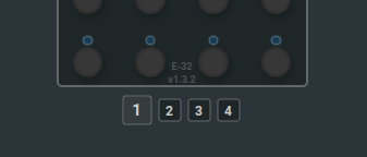

Are you using D51 or ESP based modules?
In this example E-32 means ESP32.
