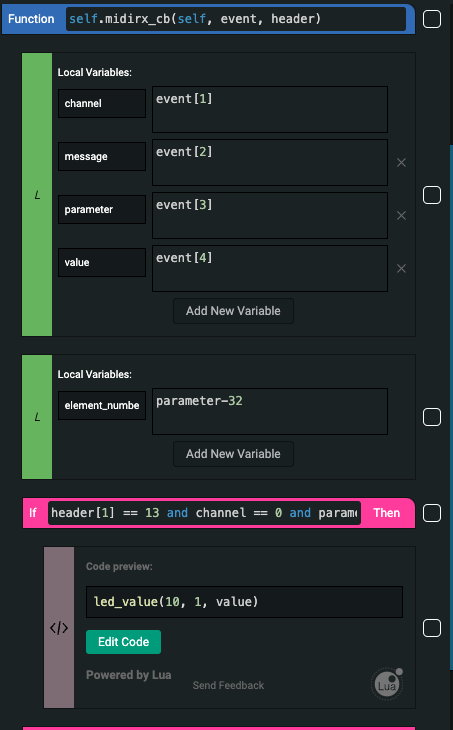

Yeah no problem! So I’m using Reaper, but I think the idea works the same with other DAWs. Basically, the DAW will send a midi message when you do certain things - as long as it’s setup to send MIDI about that particular action. So for example, Reaper is coded so that when you hit the solo button in the DAW it sends a Note E-1 On message with velocity 127. You’ll need to have Grid up with the MIDI monitor section ( prefer the debug view in there personally) open to see exactly what your DAW is sending, but it’ll look like this:
Screenshot 2025-12-29 at 20.55.12
Blue is what Grid’s received (in my screenshot disregard the contents of the blue messages, I closed the DAW and it sent all that - the green is the important one). Then, for my solo button I had to setup a function with some local variables and made an If statement that says if it comes from the DAW and its on this channel and parameter 16 then change the LED of the button based on the value. If you used my syntax for your use case, I don’t think it would do anything but change the LED value on your encoders…at best, but I could be wrong.
Use
element[0 through 7]:led_value(1, value)
instead of the global led_value(num, layer, value), that works
as expected for the TEK2 buttons.
