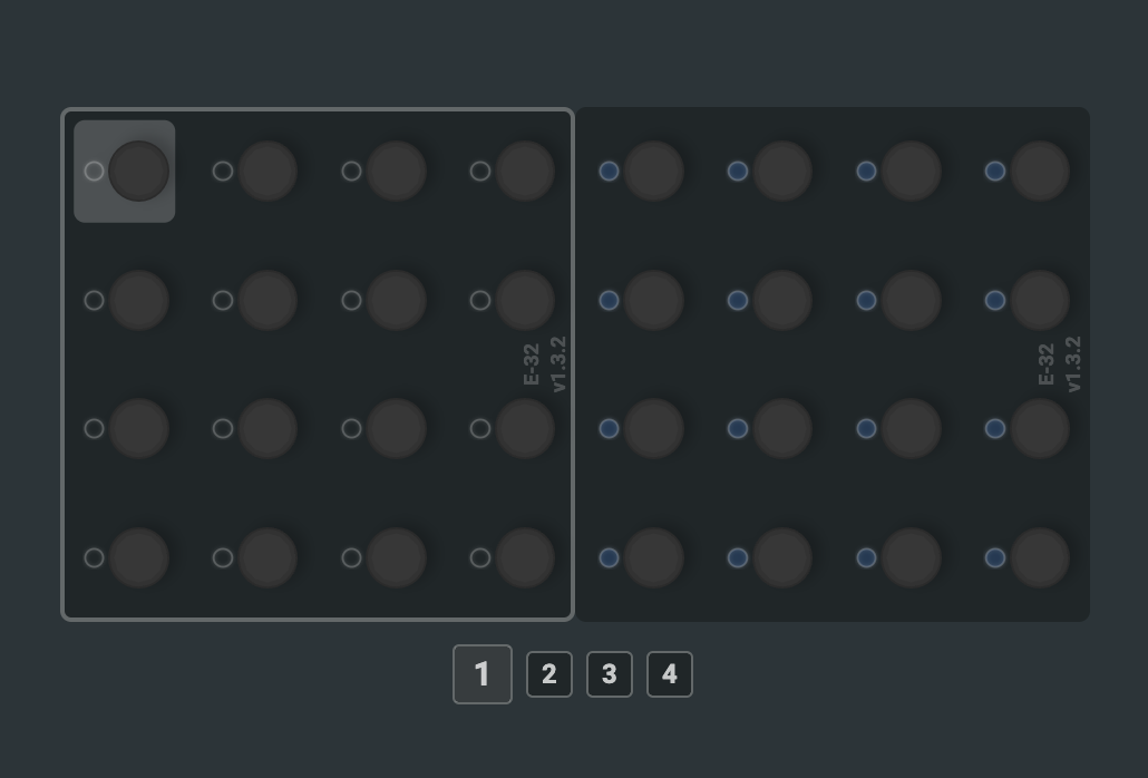

I have two EN16, left has 1.3.3 hotfix you shared, right one had old firmware
after store, left one kept my config while right one got reset
pls note that grid editor thinks thinks that it is 1.3.2 (at least it shows so)
