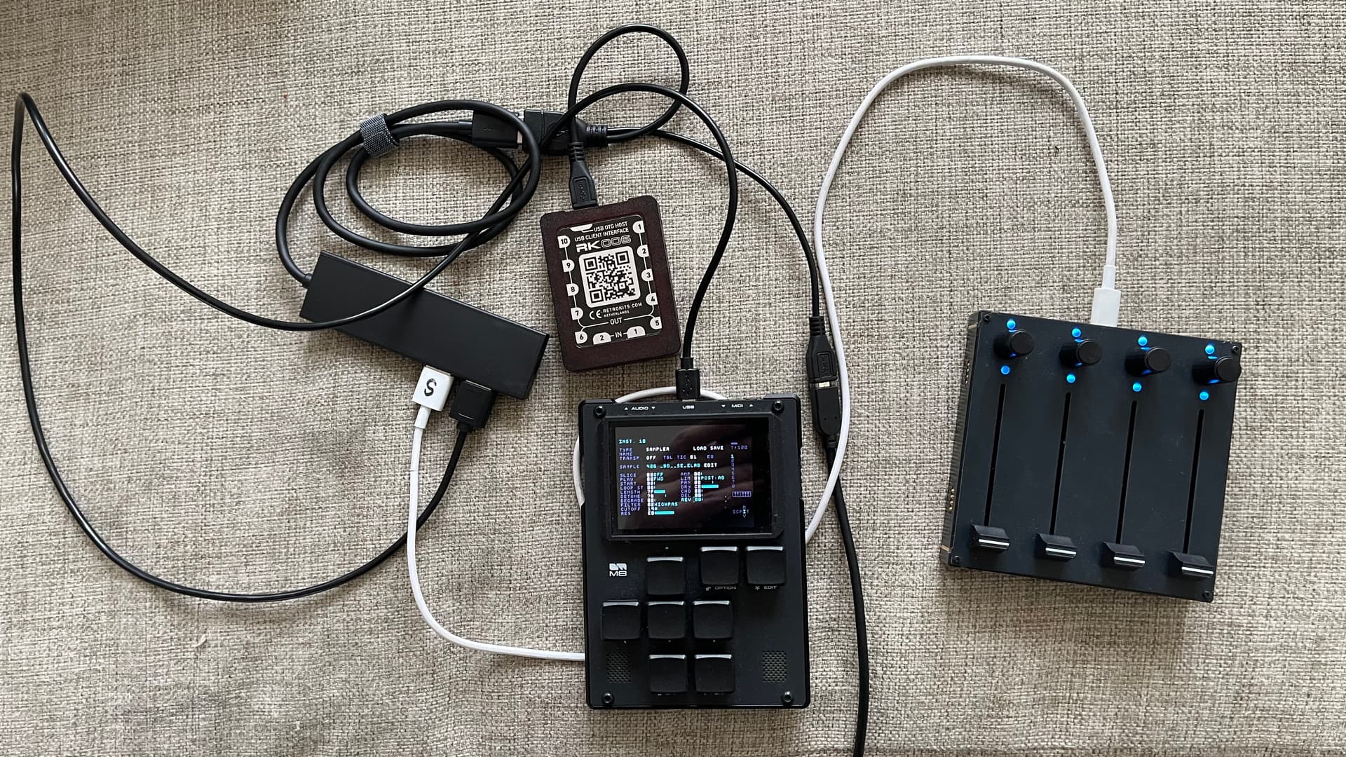

Testing Midi via USB-setup. I don’t get it to work.
Here comes another approach to solve the problem: In fact I get the following setups to work like a charm:
  • M8 + LLP (Launch Pad Pro)
  • M8 + RK006 + LLP
  • M8 + RK006 + IntechStudio Grid Controller
What I don’t get to work is all of them together.

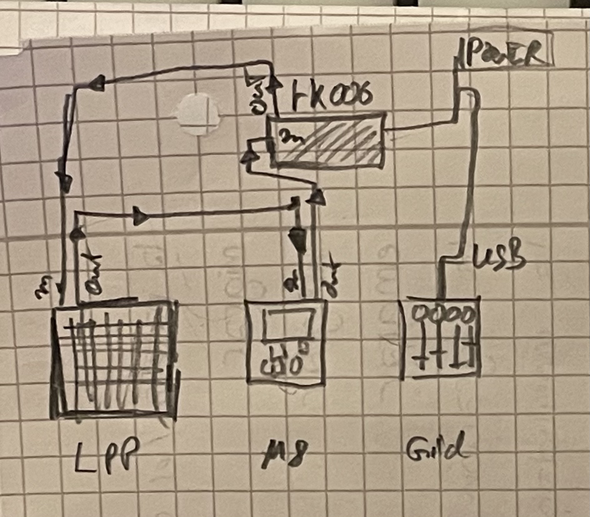

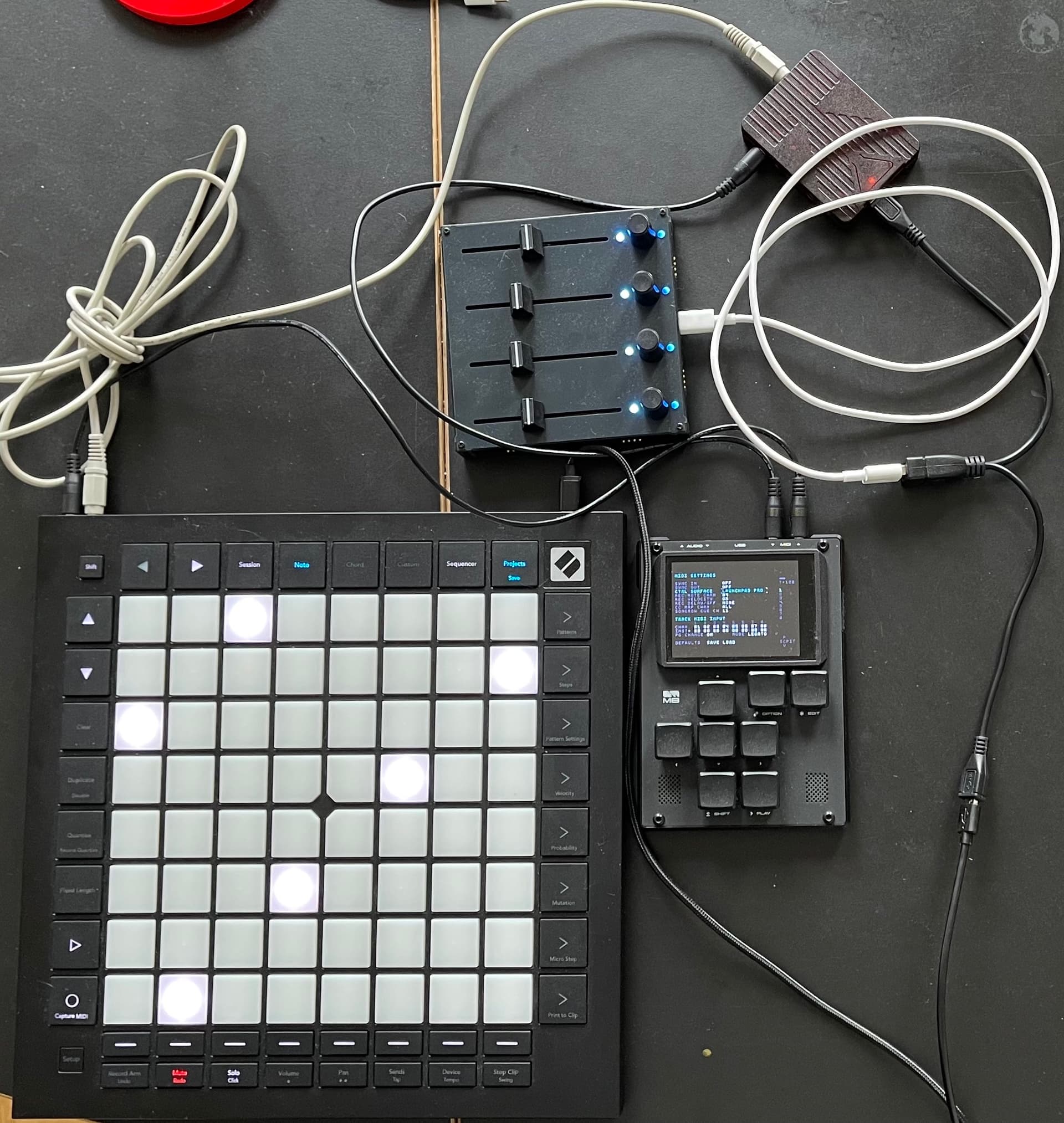

I get the setup connected so that the LLP shows the Launch Pad Pro mode of the M8. But when I move f.e. the fader of a grid controller some weird stuff happens on the LPP (like changing the color of a pad). So for me it lkooks like there is some kind of midi loop from the routing of the MK006. I seem to control the LPP from the grid, which I don’t like to happen. Best would be if the grid controllers only send midi to the M8. For this, the LPP in M8-mode would need to have a Midi through setup, but this is not enabled when in M8-mode.
The setup I talk about looks like this:
The most awesome solution would be to only use USB Midi with a USB Hub connected to mk006, connecting M8, LPP and grid controllers to the hub. But thats a different approach I tried before that also did not work.
Seems like I am at a dead end.
O.K., I found a solution:
M8 (TRS) ↔ LPP
M8 (USB) ↔ Midi Hub ↔ RK006
Intech Grid (USB) ↔ Midi Hub ↔ RK006
Yea!
