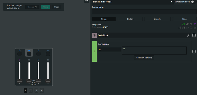

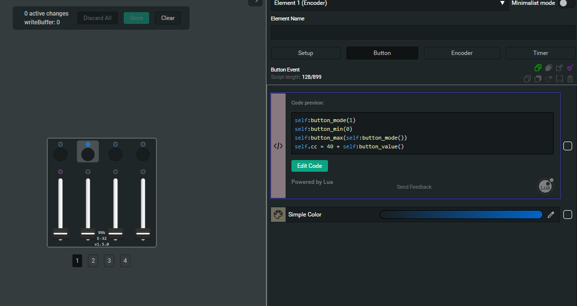

I set the default CC = 40 via self.cc = 40,

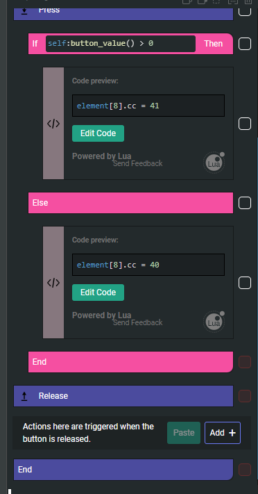

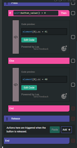

I can check the encoder sends on cc=40, then when I press the button 1, it changes to cc41 as expected, but it does not change back to cc = 40 when toggling off on the button (ie it’s not executing the Else part of the code). This is my code on the button:
Have I done something wrong?

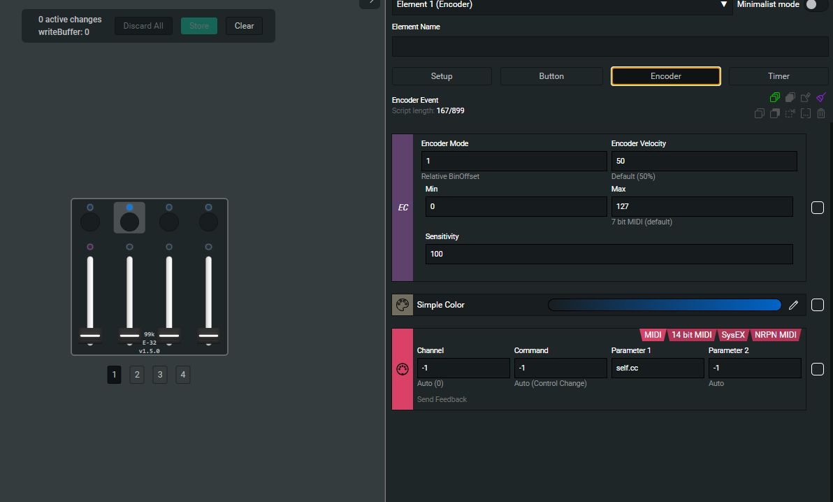

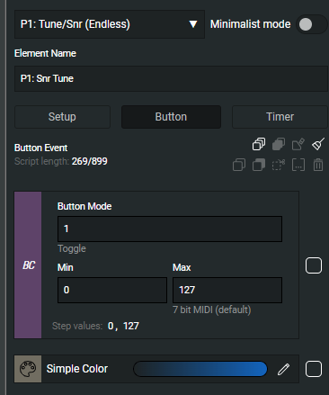

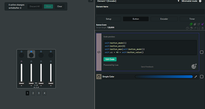

Here’s the rest of the button set-up…
I’m on a VSN1R with encoder, rather than the potentiometer used previously in the video…not sure it makes a difference.
I ended up having to re set-up the config for this, and now I can’t even get it to change to 41 (from 40), let alone back again. Not sure what is different, it looks like exactly the same set-up…to me!

You can circumvent that by using Relative Mode on the Endless/Encoder.
And by watching the video and doing the same thing as you did I can confirm that the code shown there doesn’t really work like that anymore.
I would do the following in your case instead:
This will result in a Relative Mode encoder switching between CC40 and CC41 when you press the button.
