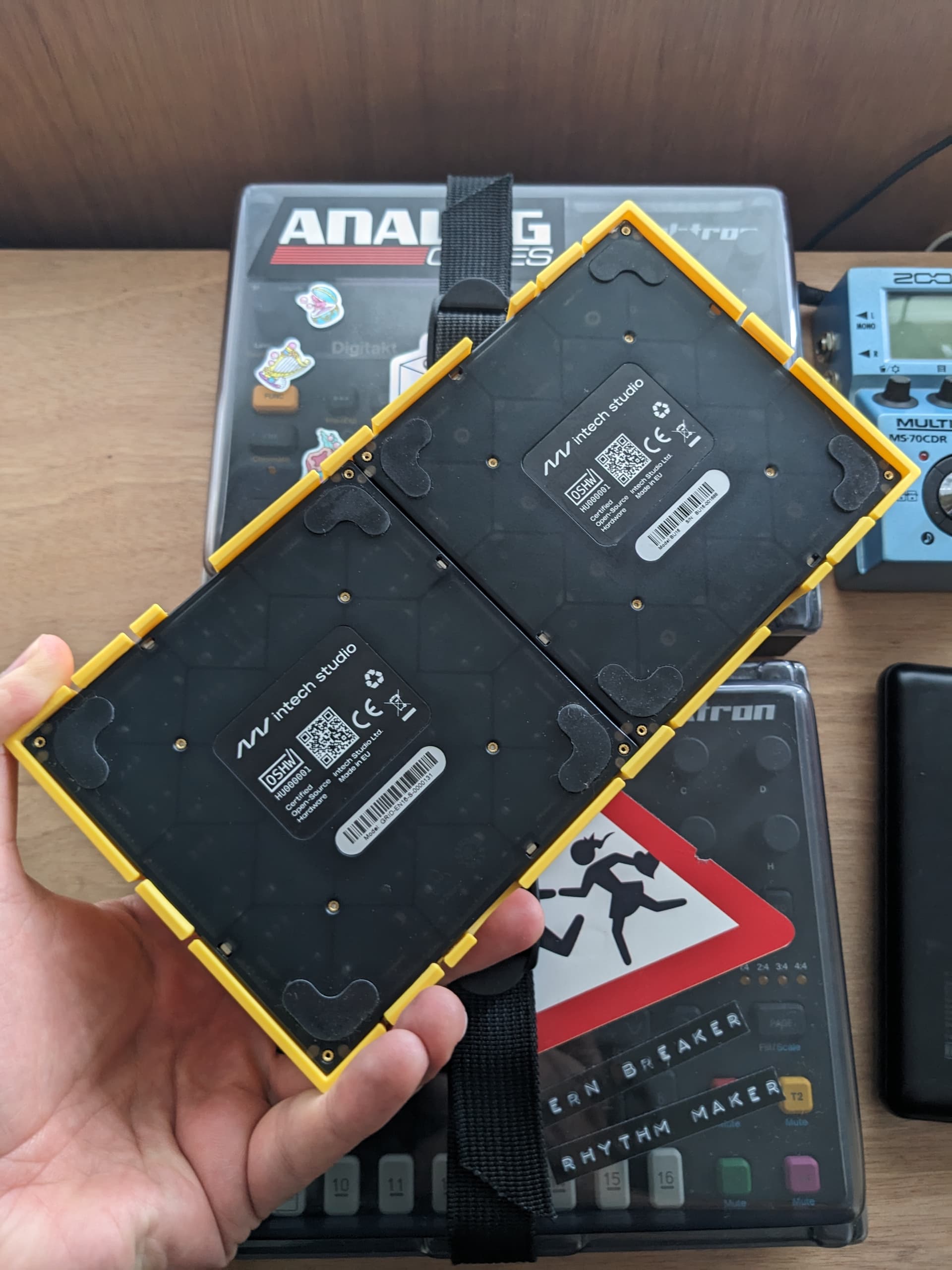

Making a cover for the modules :)
I’ll share the file for printing once I finish adjusting. I still leave too much tolerance in the models for these new crazy precise machines xD

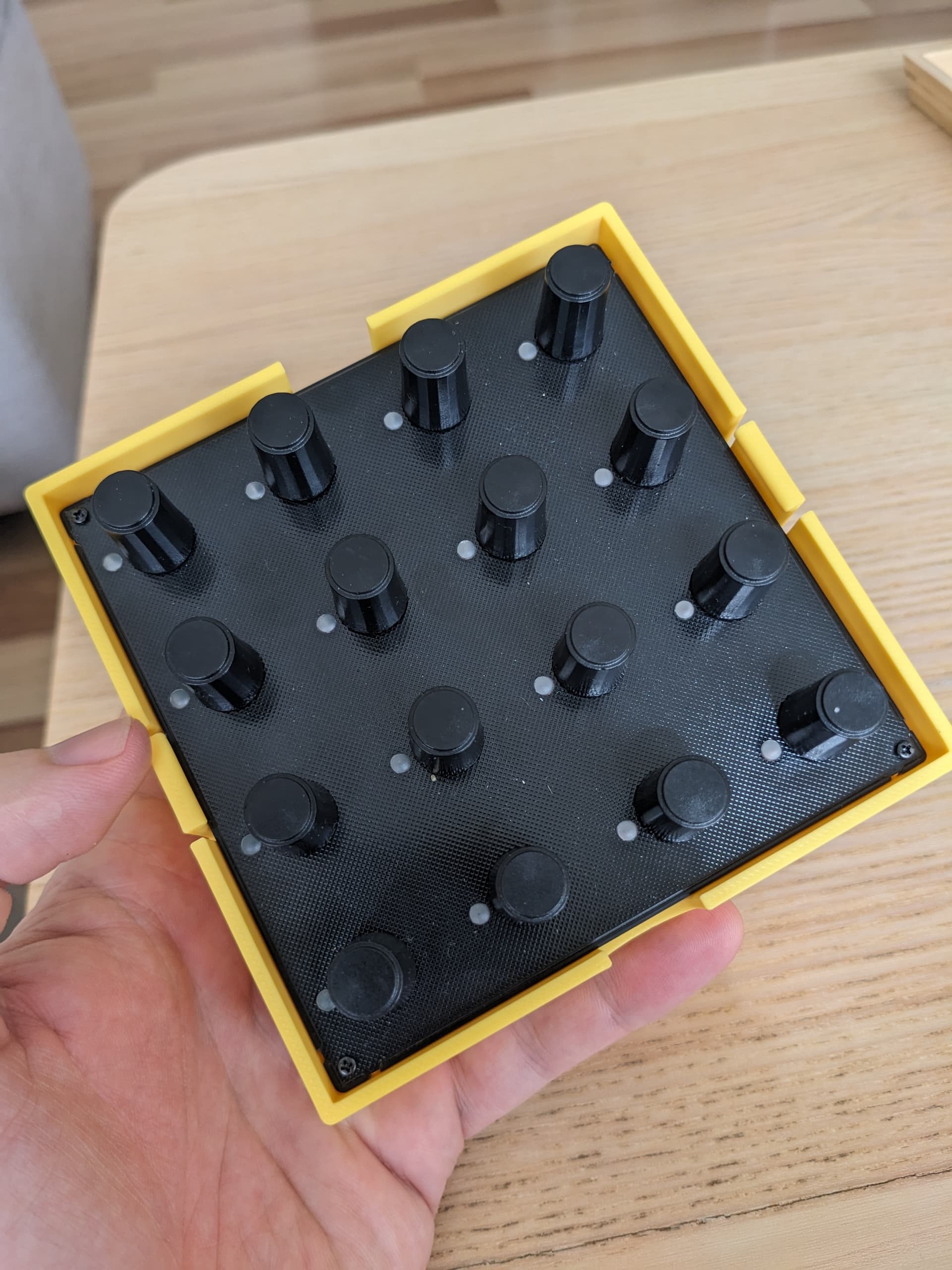

Model is an iteration over another model I saw online but has wrong dimensions the one I found online is too tight and if you fit the controller in is veeery hard to take it out.

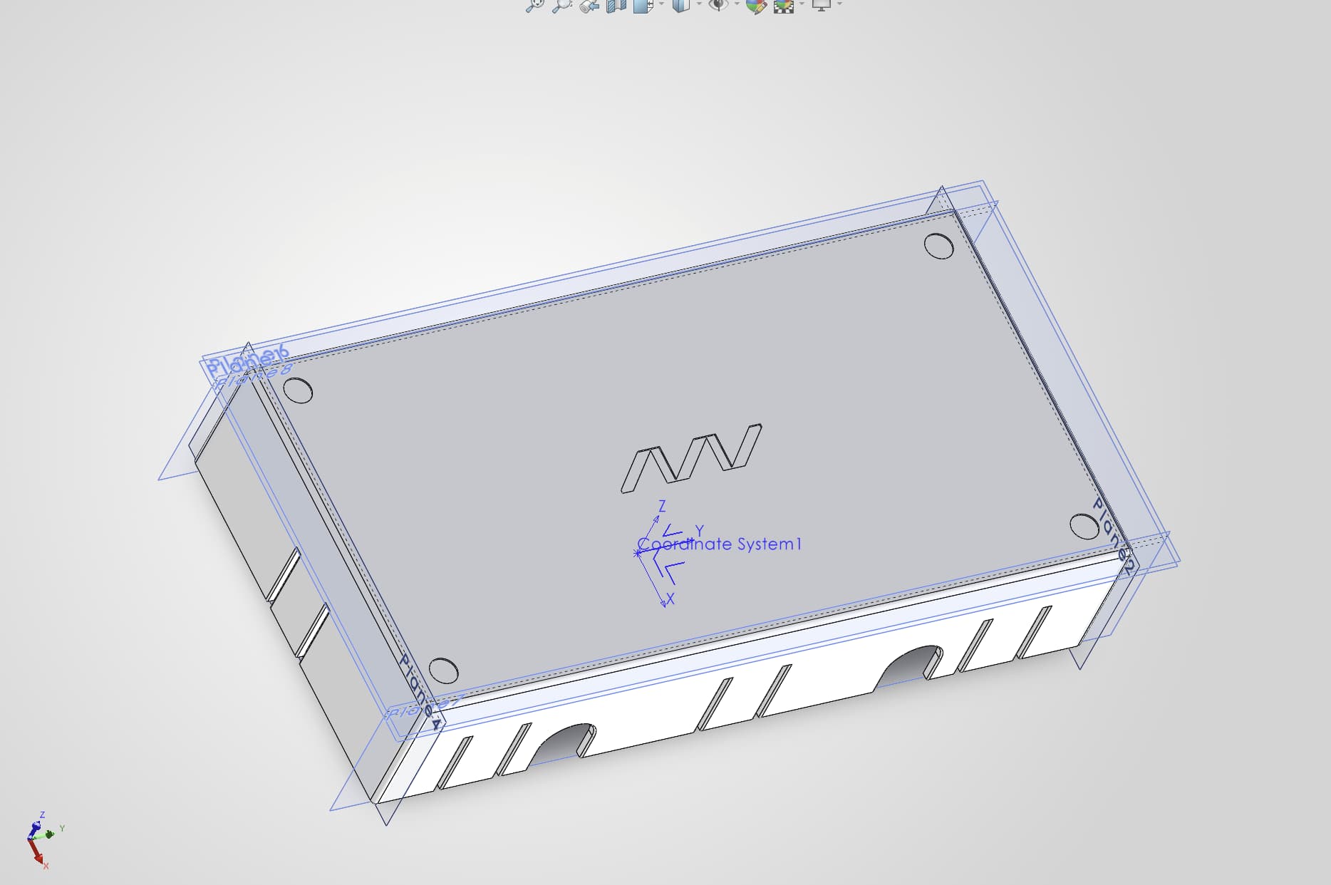

what are the issues with the double?
The order of some operations took material from the triangular risers in the centre.
I corrected the model yesterday, will update the one in the shared folder. I’ll let you know when I do it.
I updated the double case file in drive, and this is how it looks :wink:

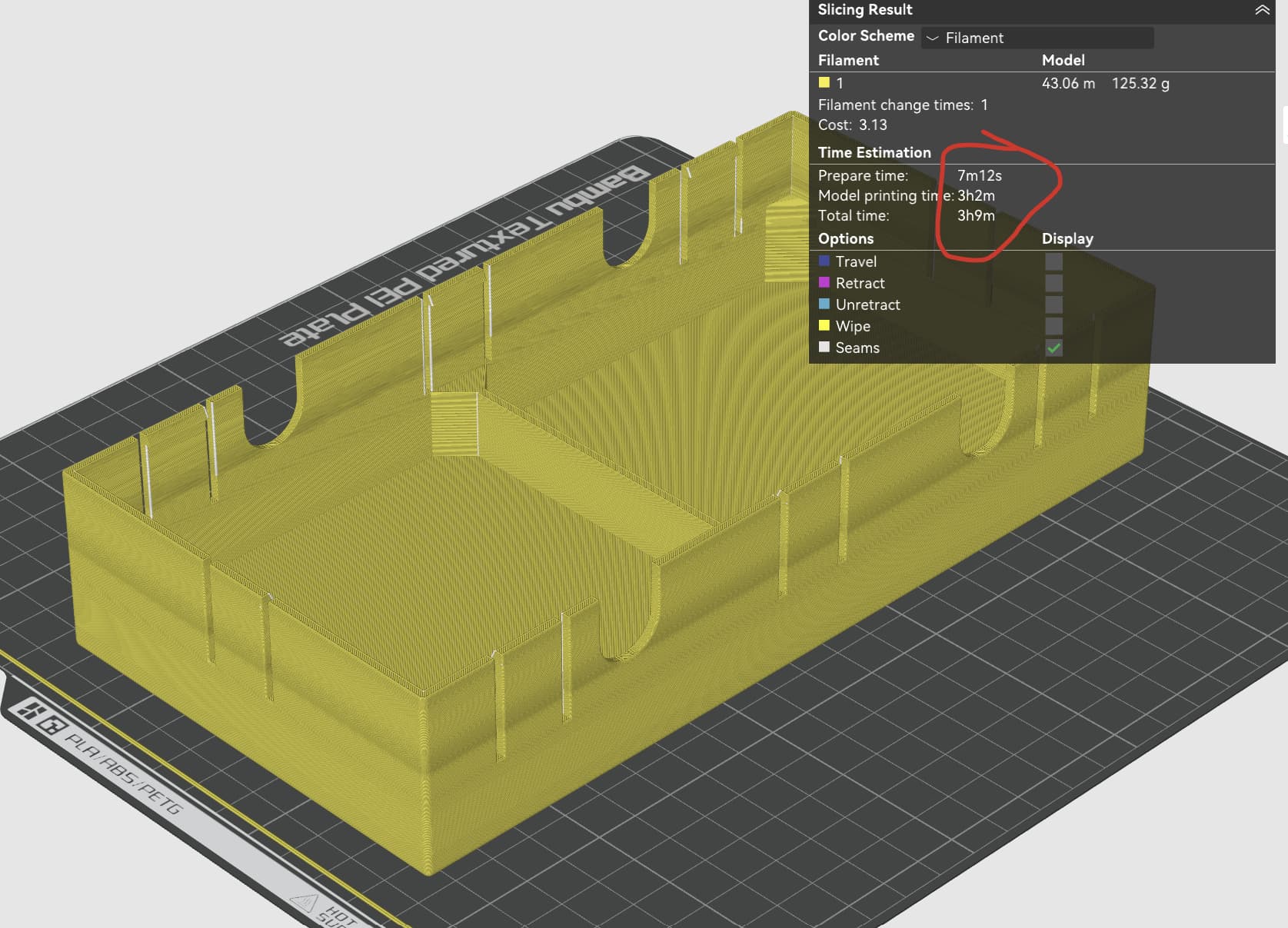

Just looked at the print time - Over 5 hours. I’ll hang on a while before printing
Yeah, it’s around 3h on a P1S.

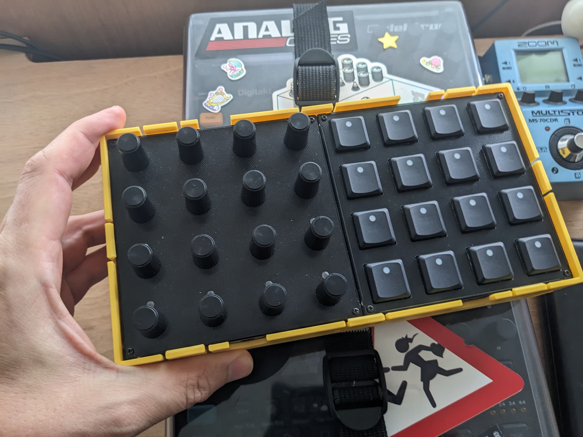

I printed one single case and two double cases yesterday with a Bambu Lab A1. The prints went perfectly and the final result looks great.

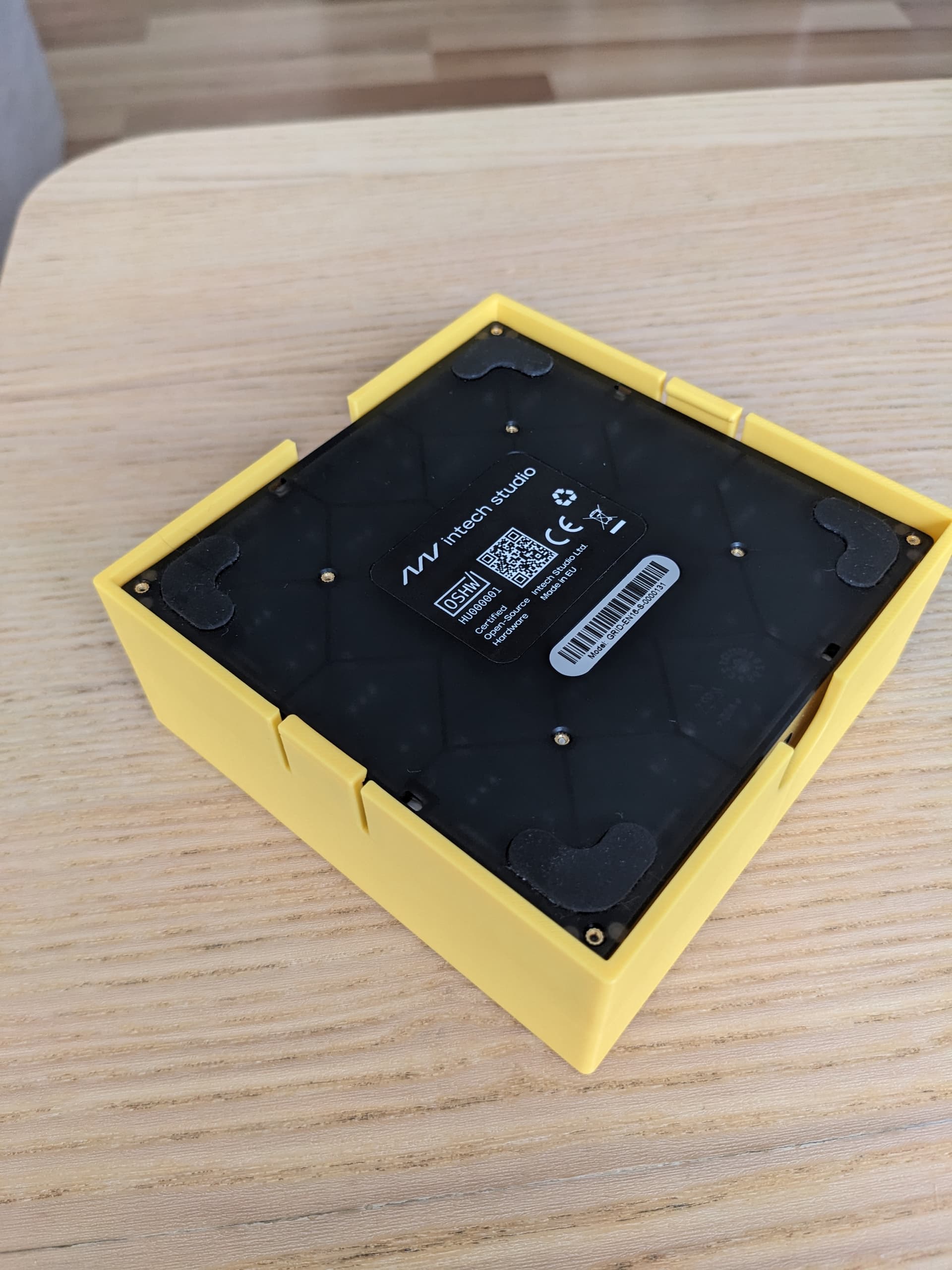

However, the devices do come out a bit too easily, especially with the single case. The case itself seems to have the correct tolerances, but the retention tabs might be slightly too short to properly secure them.
Hey thanks for the feedback!
Ill add a version with more prominent tabs.
