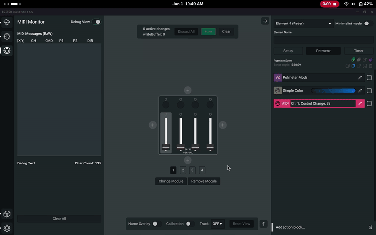

Hi Daniel,
If I understand correctly, you want to send 0 instead of the value based on the fader position, whenever the value of the fader would be equal or under 30.
This is kind of simple to achieve in Editor, let me show how:
zero_if_lower_30
There is also another way, which might be better. This just limits the value output of your fader from 30 to 127 and is much simpler to configure:
limit_fader_range
Hi Narayb!
Thank you so much!
That second suggestion I already did, but that method was lacking the “channel mute” that I was hoping for. Your first suggestion is exactly what I was looking for and i’ve already put it on all my faders.
