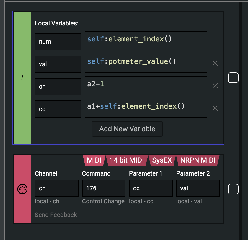

and each potmeter setup is set as this :
Sorry, thanks by the way :slight_smile:
