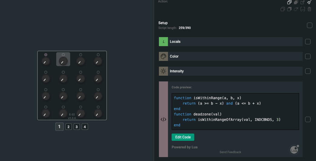

As far as I can tell, the debug messages say that you do not have the “deadzone” variable initialized.
Can’t find anything else wrong with the config, but that doesn’t allow it to work, as “deadzone” should be some kind of global variable you forgot to (?) initialize.
deadzone is a function defined on element one of the controller, you can see it in the config above at controlElementNumber": 1, event 0
Oh that’s true. Sorry about that.
