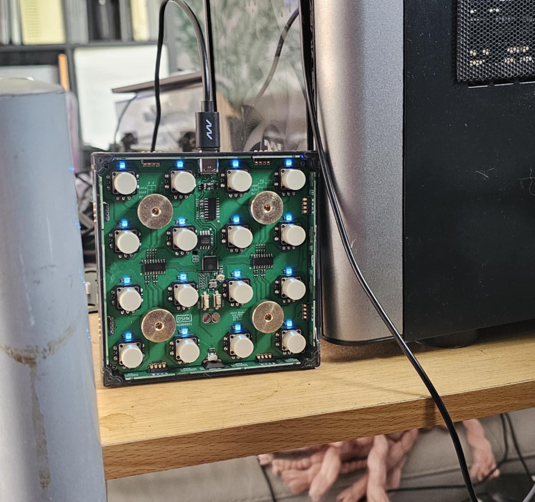

On Saturday night my button controller took half a pint of Guiness to the face. It was an unfortunate mistake where the wonderful bar person put the pint where I couldn’t see it and where the latch of the booth would knock it over when I entered.
I wiped it down and turned it upside down for a bit, but I kinda needed to keep using it so I did. It didn’t initially exhibit any symptoms, but after a little while the LEDs started going a bit mental, so I unplugged it and left it sat upside down on some tissue for the rest of the night.
Yesterday I took the faceplate off and just went to town with IPA and a brush. I have to say I can see why they’re so damn expensive, that thing looks incredibly well built.
Anyway I have it plugged in and am watching for any odd behaviours. So far so good.
Moral of the story: keep alcohol out of the DJ booth. Will I heed this moral? God no my karaoke hosting shift is 7hrs long without breaks. I need my Guiness.
Oh yeah if you’re curious about how to get the face plate off, it’s easy:
  1. remove the four philips screws on each corner of the faceplate
  2. scrabble around with your fingernals trying to get it off
  3. head upstairs to find a spudger
  4. hear your daughter say “oops. Well I guess he was trying to get it off”
  5. Ask what she did and hear that she turned it upside down and it fell off
  6. commend her obviously superior technical skills

Does anyone from Intech have any experience with attempting to apply conformal coating to the PCB? I have some and I think this would likely prevent this kind of damage…
We didn’t experience with such a thing, sounds cool though.
