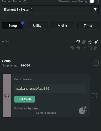

If you don’t need incoming MIDI and you only controlling software, try disabling MIDI RX by adding this in the System Setup:
midirx_enabled(0)
