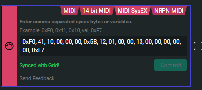

Hi!
It seems that the SysEx action block requires the “0x” prefix to recognize HEX values and also requires you to space your values with comma. So the above mentioned message will work when entered in the following way.
Thanks a lot!
It worked. However, I had to prefix each of the two-digit codes with a “0x.”
