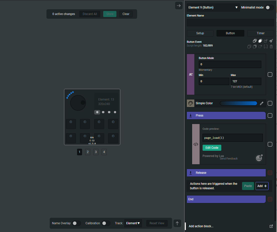

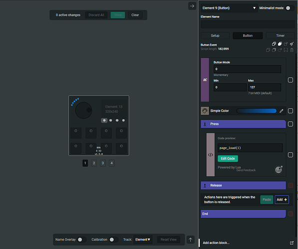

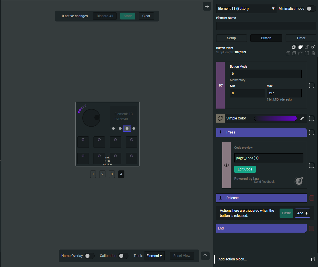

The 2 screenshots above show how I have tried to configure buttons 9-12 (the 4 small buttons below the LCD screen). The 1st shows how button 11 for page 4 is set-up (with the same setting on button 11 for page 1-4. The 2nd shows how button 9 for page 1 is set-up… again the same setup for button 9 for all 4 pages.
The aim is to emulate the pressing of the little utility button on the bottom edge of the controller - ie press button 9, changes to page 1 (from any other page), through to pressing button 12 changes to page 4 (from any other page).

Regarding the module not communicating to Editor after switching to page_load(4) with the press of button 12: the code means you’re switching to Page 5 actually, because Pages are numbered from 0 and Grid lets you do this, but Editor does not support it.
Because of this, Grid will work properly even on Page 5, but you can’t configure it.
